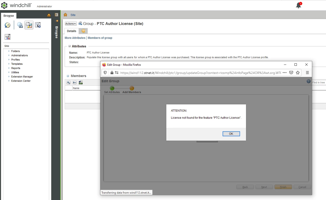

My customer updated licenses in a Windchill 12.0.2.1 and they do not have access to any of the options that are present in the Site->Utility
As a matter of fact :
Administrator has no licenses and it doesnt belong to the exclusion group (or Profile)
Even though the customer has a Windchill base they do not have :
PTC AUTHOR licenses
PTC PDMLink module license
and when we tried to add a user to the PTC author license here is what we have received  the message in the screenshot attached.
Also you can find the bin file that user has.
The case number is  : 16103496
Thank you for the help as it is a bit urgent

It sounds like the administrator account has either been added to a license group that is not allowed access to the site utilities or the account has been removed from the 'Administrators' group.  Take a look at these articles:

I agree with TomU, and the articles he pointed to - this is the cause of that issue, over 90% of the time.
It looks like you have a meeting scheduled with a Support engineer to look at this, so that is the best route to go.

Hello @MichaelChatel  @TomU
Thank you for you response.
At first i tried to informed them with the content of both articles and they informed me that their Admins were not added to any group ...
But after a Teams session , i went and replicated the behaviour exactly by adding my admin to a License group and then i recontacted the customer insisted that this IT IS actual the case, they fixed the issue .
Big thank you.
