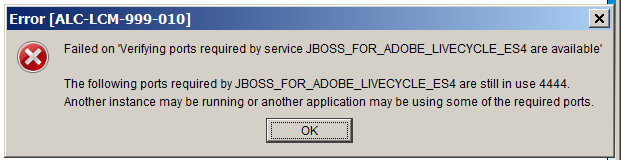

Can I Install AdobeLiveCycle on the same server machine of WIndchil?
The Adobe Documentation doesn't recomended this option, but i talked with PTC specialist he doesn't see any problem.
The PTC's virtual Machine came both in the same server.
Someone has any experience with this?

According to article CS50925, LiveCycle and Windchill should not be installed on the same machine. Though, the article doesn't explain why. From what I can find, it sounds like the reason is that there are port conflicts between Windchill and the JBoss server that is installed with LiveCycle. Though, if that's the only issue, then using non-standard ports for either Windchill or LiveCycle should allow both to be run on the same system.

Hi Chris, I Believe you are correct.
I tried to install in the same Windchill Server and i have problem with port 4444, apparently used by java.

You should be able to change the port number of JBOSS and Tomcat. So that does not look like a reason for not running both on the same server. From a server load  perspective it is good to keep in independent servers.
