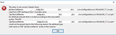

Mar 6, 2020 10:27 AM UTC
Hi Arpit-Singh , thank you for helping.
I tried that but it wont let me do the changes via WindchillDS see screenshot below.
Mar 6, 2020 10:49 AM UTC
May be you could export, change the entry and import again.
