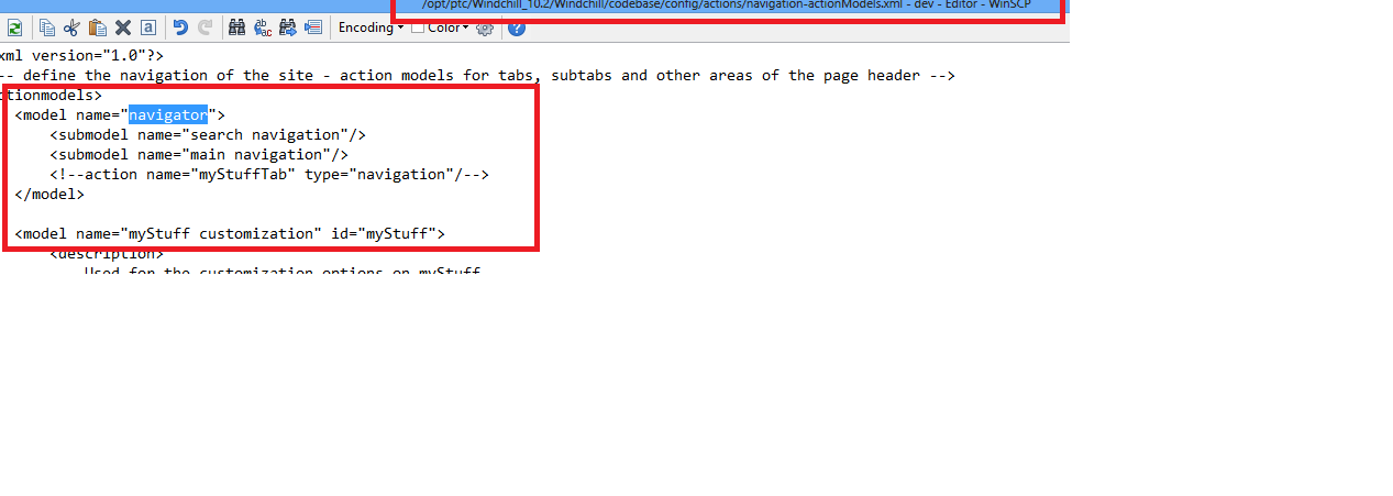

After restart of windchill server, we are facing issue, Windchill blue screen is coming no navigation bar is seen?

2016-10-31 15:13:56,897 INFO  [NmActionService.initXml] com.ptc.netmarkets.util.misc.StandardNmActionService.xmlInit  - Started initializeXML()
2016-10-31 15:13:59,129 WARN  [NmActionService.initXml] wt.method.server  - Uncaught exception on thread: "NmActionService.initXml" [id=35]
java.lang.ArrayIndexOutOfBoundsException: 7602276

2016-10-31 15:15:26,784 ERROR [ajp-bio-8010-exec-1] com.ptc.jca.navigation orgadmin - problem getting the main navigation action model
(com.ptc.netmarkets.util.misc.miscResource/400) com.ptc.netmarkets.model.NmException: actionmodels.xml file is missing an entry called navigator.  Please add the model and restart the server.

2-Explorer
Oct 31, 2016 12:15 PM UTC
it looks like navigator is missing in \Windchill\codebase\config\actions\navigation-actionModels.xml
Could you verify this?
Regards
Binesh Kumar
Medtronic
mprasad12-AmethystAuthor
Oct 31, 2016 12:32 PM UTC
Hi Binesh,
Navigator is present in the mentioned file ...
It is there .. Please refer the image attached.
I feel it is due to some cache cleaning issue or due to ""NmActionService.initXml] com.ptc.netmarkets.util.misc.StandardNmActionService.xmlInit  - Started initializeXML()"" Please guide
