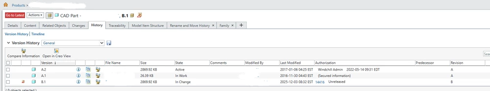

After Revise Latest Revision Isn't Showing Latest Revision
Version: Windchill 13.0
Use Case: After Revise the new Rev isn't showing as latest
Description:
I am testing an upgrade to Windchill 13 and have this weird issue where after a Revise, the new revision isn't showing as latest.  Anyone with any ideas?
Dec 5, 2025 3:02 PM UTC
Hello Marco,
So I cleared my browser cache and restarted the browser and it was fixed. Strange....

Dec 5, 2025 1:42 PM UTC
Hi Brian,
in the current version in use, is your revision scheme single-level (A1) or multi-level (A1.A1 or A1.A1.A1)?
I am asking because we also encountered some problems during the conversion from a multi-level revision scheme to a single-level one when we updated Windchill from version 12.0.2 to 13.0.2.
Marco
Dec 5, 2025 1:52 PM UTC
Hello Marco,
We are using a single-level scheme.
Brian
