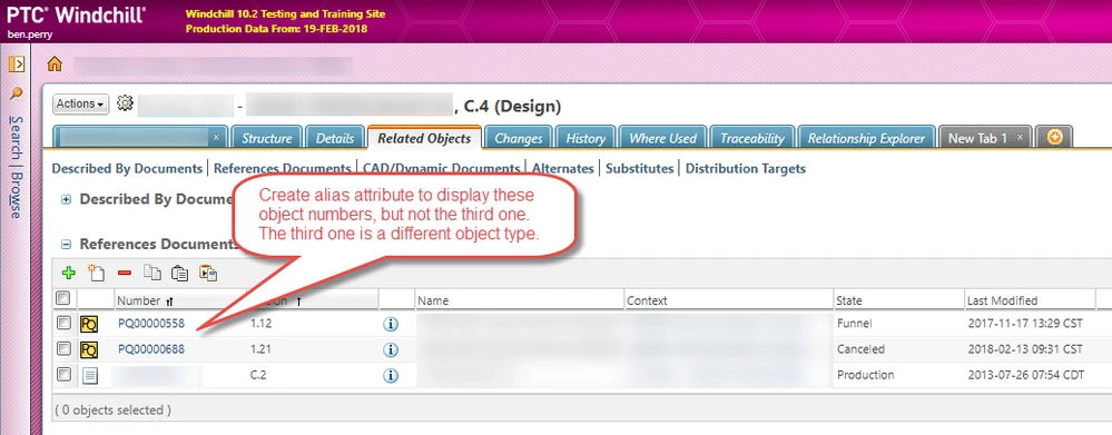

I've been searching around trying to figure out the syntax for alias attribute on a WTPart.  It should display the Number of the WTDocument that is associated using "References Documents" association.
I have seen a similar article here:  https://www.ptc.com/en/support/article?n=CS106471.  However, this is the opposite direction.
Specifically, I would like this to only pertain to my soft type WTDocument ... not all of the WTDocuments that are associated with Reference link.  Screenshot shown below to help describe the situation.
desired resultdesired result
Feb 27, 2018 2:58 PM UTC
I dont think that is possible because the link is on WTDocumentMaster ( CS131357 )
referencedBy@wt.part.WTPartReferenceLink~references^wt.doc.WTDocumentMaster~number
But you can try to replace by your sub type

Correct.  The mapping doesn't work to restrict down to particular soft type of WTDocument.
Does anyone know if it is possible to create alias attribute on WTPart that displays Number for particular soft type of WTDocument associated as "reference" ... not "described by"?
Do I possibly need to use a configurable link to achieve this requirement?  Or will that still not work?

Since the WTPartReferenceLink is a WTDocument Master relation it is not possible to configure this like this.
But you could either introduce a calculated attribute or as you already proposed you can use a dedicated configurable link to be navigated.
