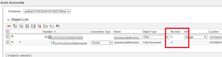

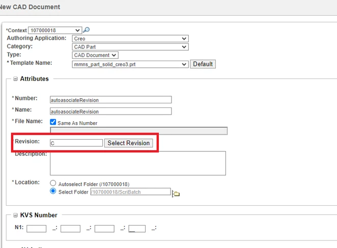

If you set the property Set Revision for Part to yes then the system synchronize the revision of the CAD with WTPart during autocreation
Example,
I create CAD with revision C as initial revision
Then the WTPart autocreation will synchronize the revisions
if the property is set to NO then the WTPart creation starts normally with A
