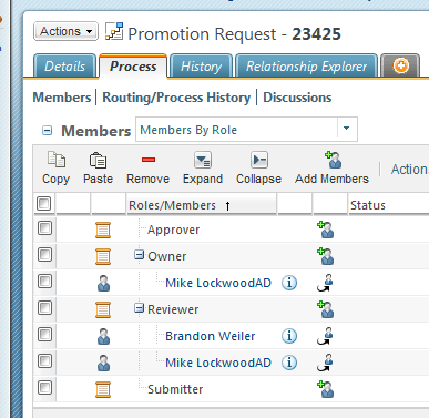

I'd like for Tony Tester to be able to add another user to the EGApprover role.
Thanks again.
22-Sapphire I
Apr 11, 2017 4:01 PM UTC
Should have these tools for a specific promotion request (shown as admin below) - I'll have to check if Modify for the Team object is enough.
note: After the workflow has "delivered" a task to any user, one cannot add another person - have to re-assign.
