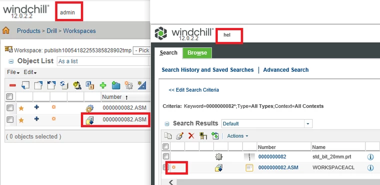

I've found solution for you.
Administrator has to grant ACL rule Read for EPMDocument on the user Domain. If you need WTPart grant same rule to wtp.
I recommend to grant it on organization level.
Allow read ACL is enough
result
There is consequence a user can access and just see other users workspace metadata
