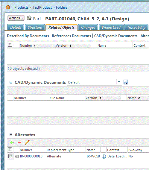

From th part 'PART-001046', I need its alternte part 'IR-0000000018'.
