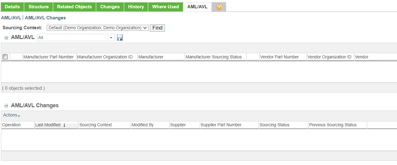

AML/AVL action icons are invisible.
Dear SMEs,
I installed windchill 12.1 pdmlink, sumalink in my local system. After navigating to AML/AVL tab in part details page, actions related to AML/AVL are hidden by OOTB validator. Can someone please suggest what to do so that I can use those actions are visible to me and I can create supplier parts.

Check your licenses first. Did you assign yourself?
You should have Windchill Advanced license too for creating Parts in general.
May 17, 2024 3:59 PM UTC
As @avillanueva mentioned, you likely don't have the licenses. If you are using license exclusion as an admin, make sure the SUMA/Advanced licenses are assigned to the license exclusion group.

Hi, I have added site admin (wcadmin) to Windchill Advanced License but still I'm not able to see AML/AVL actions. Please help.
