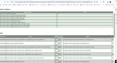

Thanks for the information . Documents are there , anyone using in Production deployments wanted to confirm.
Problem am facing in BAC utility is Target system import only works of new Objects.
it will throw error like already exists for all the existing Items . Generaly Workflows, TypeDefenition , ACLs,OIrs are iterative .

I've started dabbling with it. It's not easy to use (in my opinion). We have dev and test systems that are all cloned from prod. I can easily export and import a workflow template (for example), but if I try to make a BAC package of that same workflow template, I get errors importing it. I think there must be more setup required to get it to work correctly.
The worst part is that the errors are entirely vague and not helpful.
