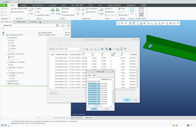

I am using Windchill PDMLink Release 11.0 and Datecode with CPS M030-CPS18
About Family Table parts,
It is managed according to the process of [check out - Generic modification - Verify - Check in].
Among these processes:
I would like to know how to process PDM check in - Fail when the Verify step is omitted by user mistake.
Currently, Check in is possible even if Verify has not been completed (completely or partially unverified).
I would like guidance on how to limit this.
Translated the text from Korean to English using google translate
Subject: 패밀리 테이블 미 검증 데이터에 대한 체크 인 실패 옵션 적용
Body: Family Table 부품에 대해,
[check out - Generic 수정 - Verify - Check in] 의 프로세스에 따라 관리하고 있습니다.
이러한 프로세스 중,
사용자 실수로 Verify 단계를 누락하였을 때, PDM check in - Fail 처리하는 방법을 알고 싶습니다.
현재는 Verify 가 완료되지 않더라도 (전체 또는 일부가 미 검증 상태) Check in 이 가능합니다.
이것을 제한하기 위한 방법을 안내받고 싶습니다.

    I asked this question,
    one is PTC case create
    the other is PTC community.
    I recieved reply from PTC technical engineer yesterday.
    reply : There is no solution to check in rule control about has been not verify family table data.
    This is what i want to know,
    I have finished Edit Family Table data, but It has been not Verify.
    At this time, Drawing (*.drw) data is diffrent from 3d prt.
    I'll trying to PDM Windchill Check-in, then It is able to check in (= check in success).
    Inspite of Family instance has been not verifying yet.
    I want to konow how to
    'If family table data has not been finished verify then Check in is Fail.'
    joe_morton
    May 31, 2024 5:34 PM UTC
    The best available solution might be: config.pro option verify_on_save_by_default=yes
    See: https://www.ptc.com/en/support/article/CS62074?source=search
