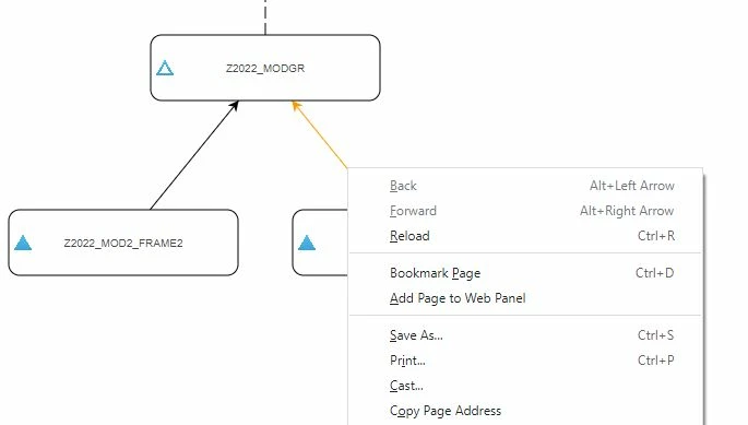

I'm testing the Architecture Editor in Windchill 12 (according to Managing the Positioning Architecture in Architecture Editor ), and out of curiosity, wanted to delete a node from the graph.
I do not get the Right click to delete neither a node, nor an interface, as it says should work. ("To delete a node or an interface from the graph, click the node or the interface and select the Remove right-click action.")
Tried in two different browsers (Chrome). Right click just brings up the usual menu from every web page. I have no extensions installed on Chrome.
Any ideas?

I can't find anything in PTCU on this. Searched for both "architecture editor" and "What's New in PLM" in "All Windchill" even. However, I know how to right click on the link, but don't get the right pop-up

OOTB the first try works as I expected in the chrome browser.
In your screen there is different type of link I guess.
What version of Windchill do you use?

If I can add link, I should be able to remove too.
I must assume the problem lies in the browser(s). But even Edge won't work for me. My Chrome is virgin, I never use it for anything, and have no
extensions.

Hi @Zoltán
My version is 12.0.2.7 so the 12.0.2.0 can have a bug in your case.
