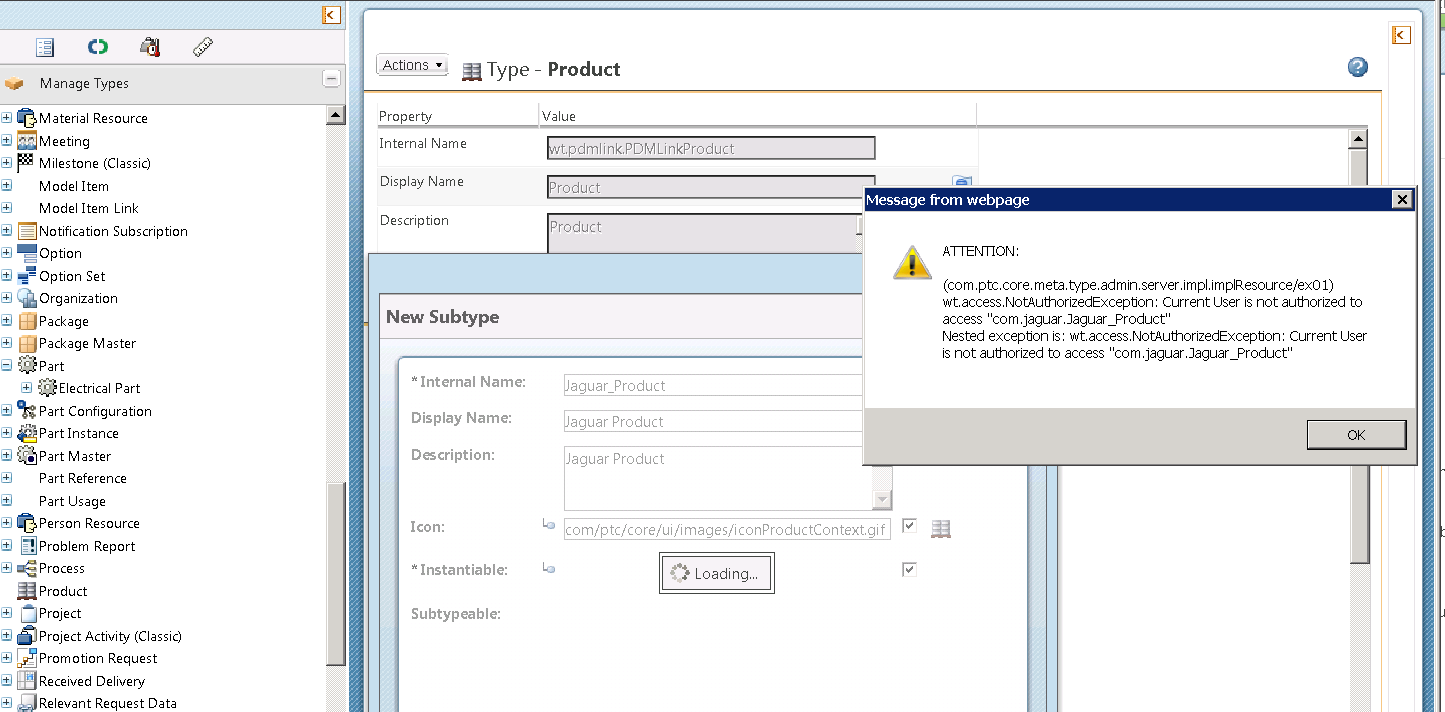

As an Organization Admin role, I would like to make a product Subtype.
When I tried to make a Subtype, I got the following message which said that "I don’t have an authorization to make a Subtype."
Do you know how to assign an authorization( i.e., making Subtype)  to an Organization Admin at Policy Administration?

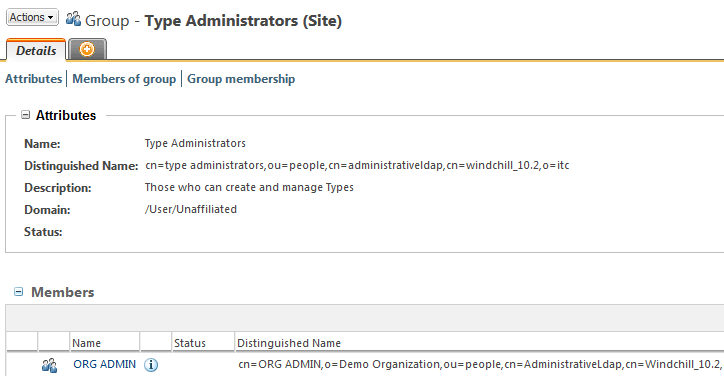

In Site context there is a group named "Type Administrators".
If you are not a member of that group then add yourself.
Cat1-VisitorAuthor
Dec 8, 2015 5:05 AM UTC
I appreciate your input.
I followed your instruction; I added my account user (i.e., Organization Admin) in Type Administrators group.
However, for some reasons,  I still cannot make a subtype.
