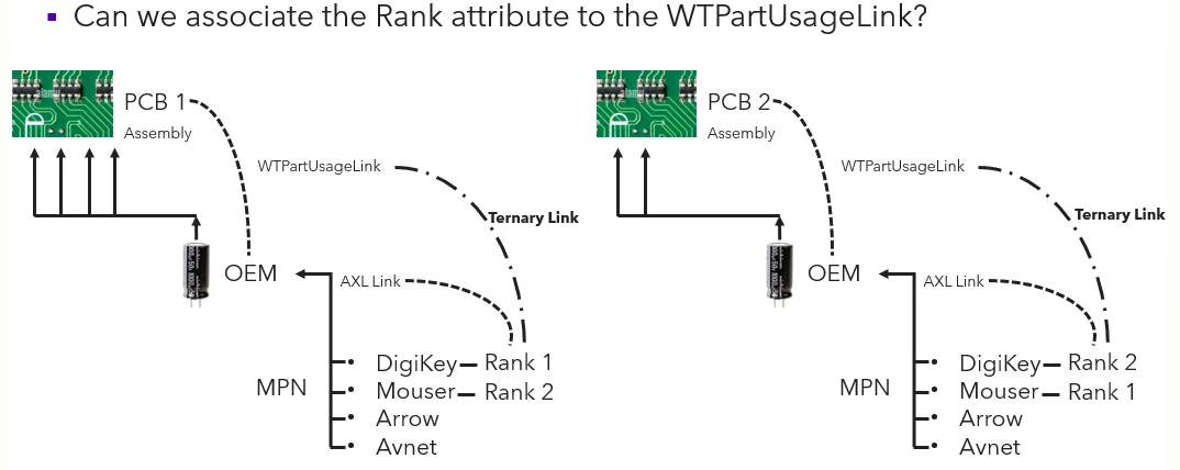

wstevens6-ContributorAuthor
6-Contributor
Jul 13, 2026 2:45 PM UTC
Hi Brian,
Thanks for the response.
The challenge we’re facing is that the “Rank” attribute needs to be ranking the MPN.  The OEM part of course can have many MPNs (from different suppliers and vendors).  If we apply the “Rank” attribute directly to the MPN, that won't work because it would then be the same value for every assembly.  If we tie it to the Manufacturer Part Association (AXL Link) between the MPN and the OEM part, that won’t work either, because again that would be the same across all structures where the OEM part is used.  So, we really need to tie it to the Part Usage, but since it is “Ranks” the MPN, we can’t figure out how to tie it to that link.  It kind of needs to be something like a ternary link (a link going from the MPN up to the Part Usage Link).  We don’t know if that is possible, and if it is, we don’t know how to do it.  We’re ok with creating some level of custom code if that’s what will be required to have that level of link association of the Rank attribute.
Here is an image that might help visualize what we’re thinking.  Any thoughts and input are very welcome!
Wayne
6-Contributor
Aug 7, 2026 4:18 PM UTC
Does anyone have any experience with “Configurable Links”? And, would that possibly be a way to resolve this by allowing us to create a new link that spans from MPN to Part Usage?  Just a thought?  I’d appreciate anyone else’s perspective on that idea.
HelesicPetr
Oct 23, 2026 7:54 AM UTC
Hi ​@wstevens
Yes the configurable links can solve your needs.
There are many types of Config Links that you can use.
There is one disadvantage. You have to create own cusotm wizard where you can manage the links.
I can see that you are going to move to a Windchill+ cloud so there are some restrictions for a customization.
You have to use only supported API for the customization.
Full process is described in a help center how to use configurable links and how to create example wizard
PetrH
Oct 19, 2026 11:22 AM UTC
Hello ​@wstevens we approached via customization
  1. Created the custom Attribute in AXL Entry, multi Valued attribute
  2. Created a custom action in Structure Browser when right click on Part
  3. When right click on Top Assembly-A, a custom table to show the associated Assembly and its MPN Components with default bom Ranking 0
  4. User can change the BOM Ranking and click ok to persist.
  5. The custom attribute value will save as
    RootPart Number | Part usage between Top Assembly-A and Assembly-A | Assembly-A Number |Assembly-A Number | AXL Entry | <bom Ranking>
  6. Data Utility has been written to show the bom Ranking based on Root Part Number, Top Assembly-A and Assembly-A
Root Assembly-A
  • Top Assembly-A
    • Assembly-A
      • MPN-A = Rank 1
      • MPN-B = Rank 2
Root Assembly-B
  • Top Assembly-B
    • Assembly-B
      • MPN-A = Rank 2
      • MPN-B = Rank 1
regards
