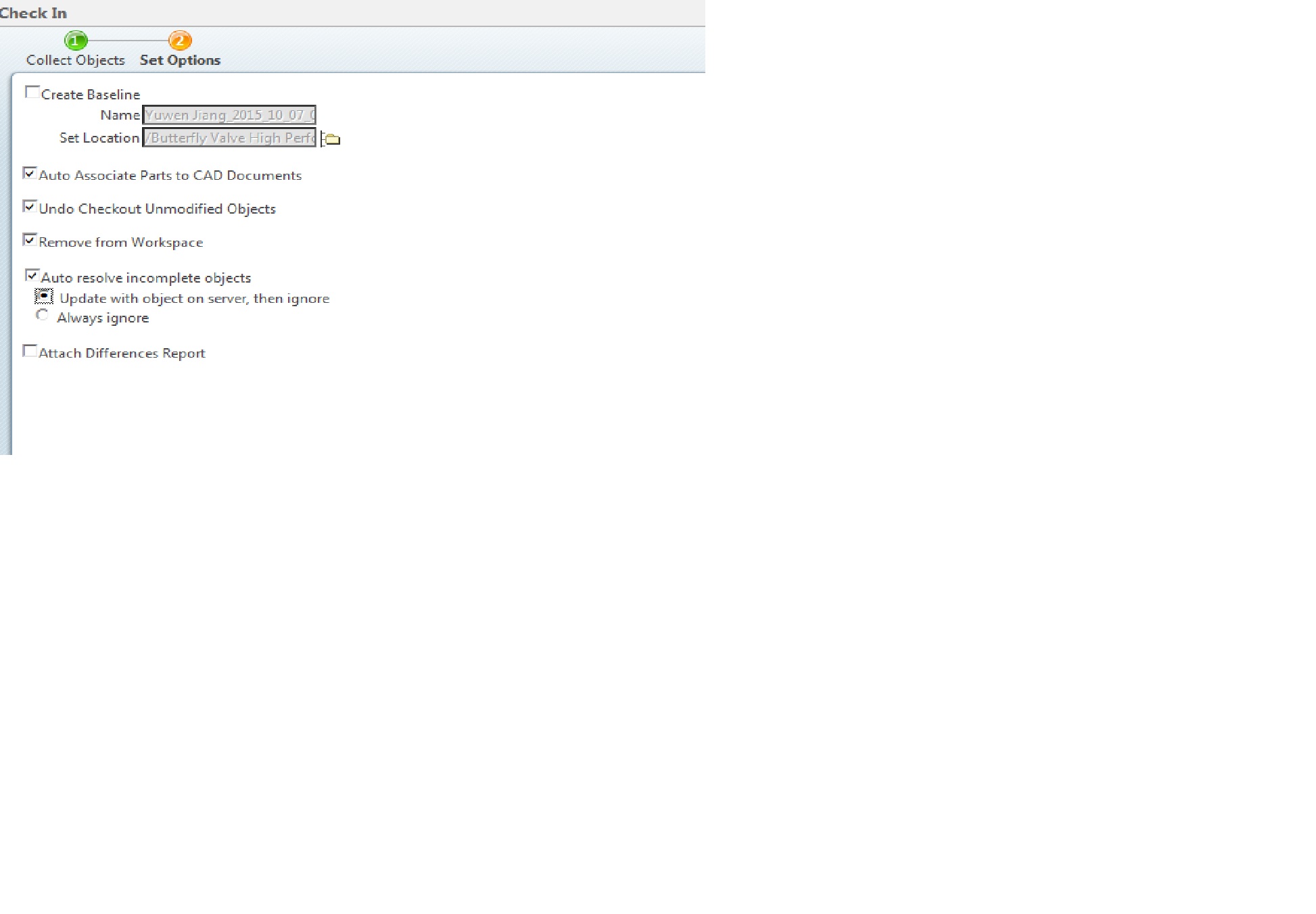

Tried the following so far: 1. Checkin the assembly from workspace and chose the "auto resolve objects" 2. Tried to "replace" the ghost object with a file in the workspace.  Please let me know if there is anything else which i can try. Thanks!
Oct 7, 2015 2:02 PM UTC
try the following, it works in our company
