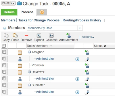

I want to send a task to the manager of that department according to the selected department. Is there any way I can assign this user directly without getting it from the form?

If you solve the mapping what user is in the selected department you can find a user and assign him to a workflow role and the role use in the task,
you need to find a team and a role from a object the workflow is related
Add the participant(user) to the role.
example from Change Task object
generally example API to add a participant to a role is >
wt.project.Role teamRole = wt.project.Role.toRole(roleName); // roleName is a internal name of role what you want to update
wt.org.WTPrincipalReference princRef = null; // you need to find your user and get WTPrincipal object in my case I have a WTPrincipalReference and from this object I fet WTPrincipal - just for explanation PS: WTPrincipal is a root type of WTUser
wt.maturity.PromotionNotice targetObject = (wt.maturity.PromotionNotice)primaryBussinessObject; // from workflow primaryBussinessObject can be any Change Object Promotion, ChangeRequest, Activity, Notice
wt.team.Team team = (wt.team.Team) targetObject.getTeamId().getObject();
wt.team.TeamHelper.service.addRolePrincipalMap(teamRole, princRef.getPrincipal(), team);
 Adding user to a role has to be done before a workflow task is run.

How can I get the WTPrincipal object?

Hi @smcvr
for example
String userName ="admin";
WTUser wtUser = null; //WTUser is subClass of WTPrincipal
		try
			QuerySpec queryspec;
			queryspec = new QuerySpec();
			int wtUserObjectInt = queryspec.appendClassList(WTUser.class, true);
			CompositeWhereExpression andCondition = new CompositeWhereExpression(LogicalOperator.AND);
			andCondition.append(new SearchCondition(WTUser.class, WTUser.NAME, SearchCondition.LIKE, userName), new int[]{wtUserObjectInt});
			queryspec.appendWhere(andCondition, new int[]{wtUserObjectInt, wtUserObjectInt});
			QueryResult resultQuery = PersistenceHelper.manager.find((StatementSpec) queryspec);
			if (resultQuery.hasMoreElements())
				Object obj[] = (Object[]) resultQuery.nextElement();
				wtUser = (WTUser) obj[0];
		} catch (WTException e)
			e.printStackTrace();
