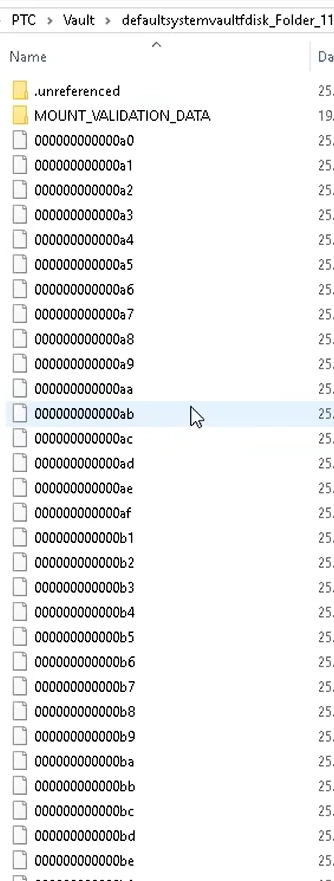

Windchill_12.1\Windchill\vaults\defaultsystemrootfolder folder. I want to decrypt these files so that I can check the files within the attachments from this location, but I can't access them because they are encrypted. I can't tell which files are PDFs. Could you help me with this issue?
Note: The files appear encrypted with names like 000000000000a8.

They are not really encrypted they are just saved with some database sequence.
If you rename the file to correct one, you can open it..
If you need to find correct file name you have to go to the database and find the correct file.
Here is a description how to find the file vault name based on epm number
but you can change some conditions and you will find what you need.
CS322648 - Find vault file path for WTDocument or EPMDocument objects in Windchill PDMLink

This is the part I mentioned. There are such files inside the vault, and I assume these are the files within the attachment. However, the existing files do not have extensions, and their names are also different.

Yes, the vaults list files (unencrypted) based on a hexadecimal value stored in FVItem table. Your not expected to try and access files with extension from this location. All metadata about this file is stored in the database. A SQL query is needed for you to reverse this and extract the actual filename from the database matching what you see in that image. Any reason the web interface cannot help you in this area?

Since you are looking in the vault folders directly, you are seeing the hashed filename that is assigned by the Windchill database using a sequence generated number. You can open these files in any simple text editor (Wordpad, Notepad, Notepad ++, etc.) and see some of the data that is in stored as ASCII text. Most of the file contains binary data and is not man readable.
