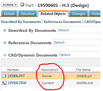

I cannot for the life of me find where the association link types are living.
I have the links, now I just need the association text...
Any help would be appreciated.
acoash11-VisitorAuthor
Mar 24, 2017 12:34 PM UTC
  • Tables:
    • EPMBuildRule: Records association between Part and EPM Document upon association creation
    • EPMBuildHistory: Records association between a Part and EPM Document when the EPM Document builds the Part or vice versa
    • EPMBuildRuleAssociationLink: Records association between a Part and EPM Document when checking in an EPM Document without building the Part
  • BuildType values
    • 2: Contributing Content
    • 4: Image
    • 6: Contributing Image
    • 7: Owner
