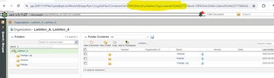

I appreciate the response. Is 'OR:wt.pdmlink.PDMLinkProduct:1048703300' an ID of a container for a product? Or what is it exactly? And for data type is that something I can use for any type of document? Or what is that exactly? Can I use an organization container like 'OR:wt.inf.container.OrgContainer:102609' ? I ask this because I am having some trouble creating products (which are reflected in my other posts).

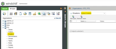

yep the "OR:wt.pdmlink.PDMLinkProduct:1048703300" is the ID of the prod where the doc is created , it can be also a library :
"OR:Awt.inf.library.WTLibrary:2956965", to be able to cerate product , add your self to an org (I know we are solving this in an other post  ) and then add your self under the org product creators table :
for to be able to create dox on org level use something like below :
OR:wt.inf.container.OrgContainer:xxx
