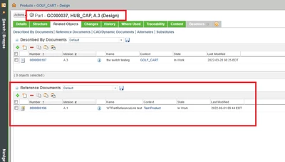

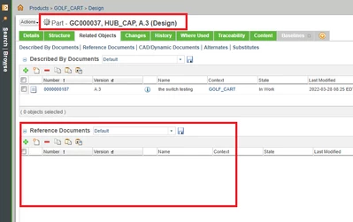

Actually, this is doable.
I wrote a method with only 4 lines of code that will link a checked in WTPart to a Reference Document WITHOUT checkout/checkin.
It's much faster then checkout/checkin and works!
Before A.3
After A.3

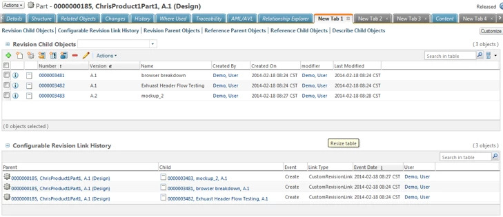

One can support attaching a Document to a Part using a Revision to Revision Configurable Link.  Once configured you will have a new table to add the Document types defined for this type of relationship.  As it does not iterate the Part there is a History capture for this so there is traceability to when things were added or changed.  These are available to use from Windchill 10.2 M020 onwards.
You can find more information in Help
