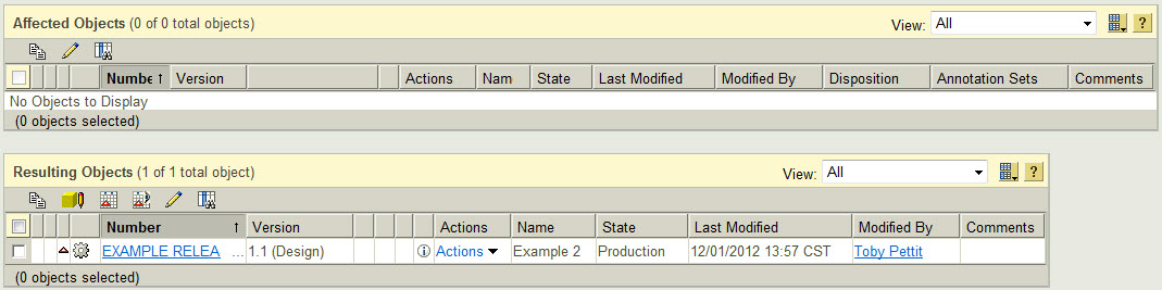

In a workflow I am attempting to create a Change Task for every changeable on a change notice automatically.
So far I can create the individual change tasks with one changeable each, but I can only get it to be associated under "Resulting Objects" not "Affected Objects" - see below.

Try this link class
wt.change2.AffectedActivityData
