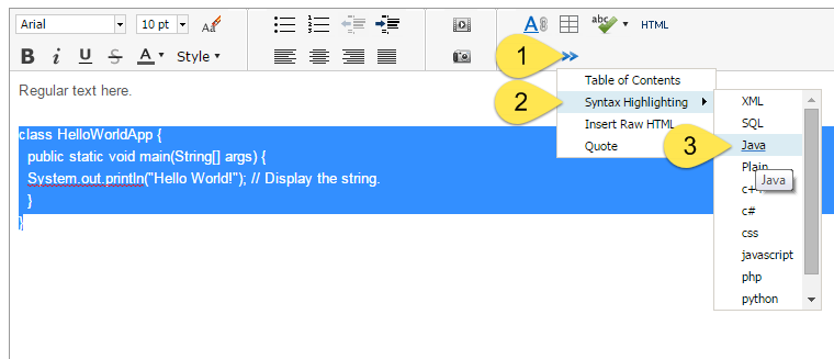

Are you interested in editing your post and formatting your java code as such?  When editing, choose the Use advanced editor button.  After entering that mode, you can highlight your code and click the buttons in the screenshot below to format your code for easier visibility.
Thanks!
