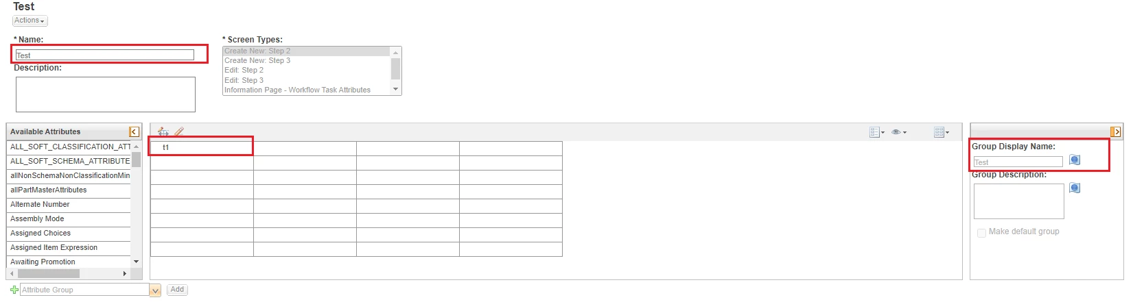

Step: 1 I create a new layout, named "Test" like image 1.
Step: 2 I created one attribute named "t1" and added it to the Test layout like image 2.

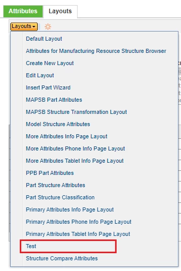

Step: 3 I want the "Test" in the Customize tab like image 3.

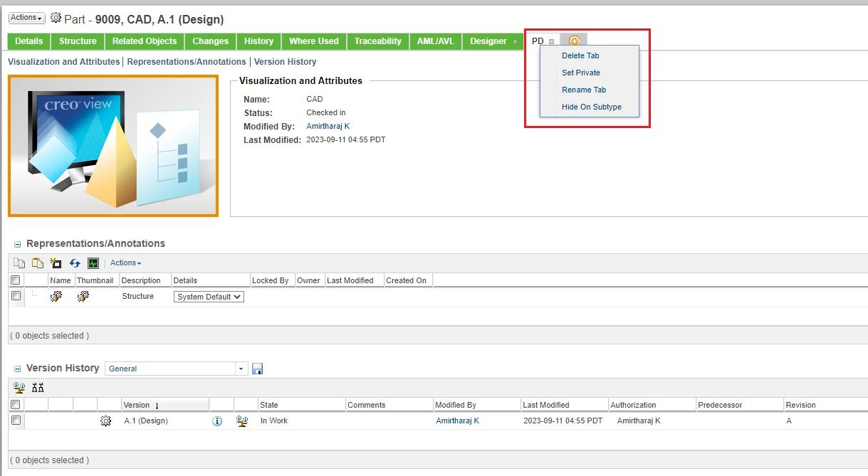

Step: 4 I created a new tab "PD" I set a public so everyone can see that, I want the same little difference I have one team handles only WT Parts Whatever he requires I added one tab and can we disable all other tabs except this.

Hi @Amirtharaj_K
If it is your real jsp custom tab, then you can add a filter(validator) to an action, where you can allow to see the tab only to specific users based on your conditions
You write validator and assign it to the action . In this case the action is your custom tab,  So you add a filter in a customAction.xml file.
here is example how to create own filter(validator)
CS52551 - How to write a UI validator in Windchill PLM

I am looking for a custom tab to enable the particular user or role-based because they don't require more tabs. For example, if it's a purchasing team they want only information like name, number, qty, replace &, etc..,
In the above, we created a custom tab named test, I want this add to customize like add this into general. image 3
Image 4 if we set it public everybody can see the tab right, I want that to role-based.
