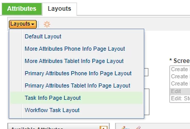

HelesicPetr
Nov 1, 2023 7:11 AM UTC
Hi @Amirtharaj_K
Go to the Layout and add the attributes to the Task info page layout
PetrH

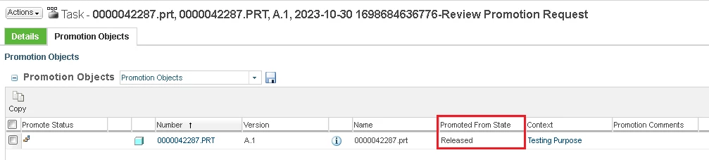

Nov 1, 2023 8:57 AM UTC
Thank you for the replied Mr. Petr, Thanks for the information.
Step:1 I create a Promotion Request for one EPM Document & it's already in "Released" state.
Step:2 Like a image 1 Promotion Object State is Released
Step:3 Image 2 State is Released that appeared in Promotion Object.
I want that attribute with value in My task. for example before promotion if it's inwork state mean inwork will appear in My Task Tab.

HelesicPetr
Nov 1, 2023 9:04 AM UTC
@Amirtharaj_K
So you want to show in the task the source Life cycle state of the promotable object?
Do you know that each object can have different source life cycle state? but just one target state?
