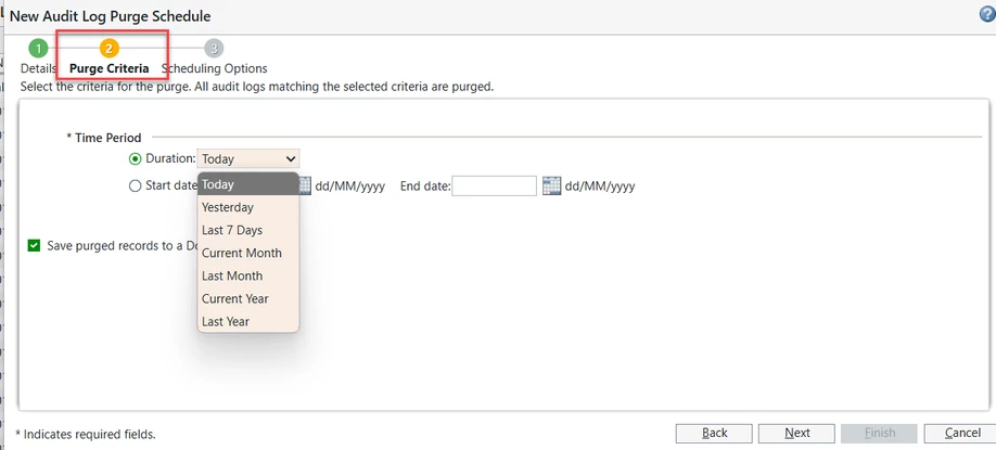

I do not have 13 yet. Can you screen shot interface? Help docs do not image details but other places allow for relative options for date like days back.
Jan 20, 2025 8:32 PM UTC
I asked the same question to Tech Supt when audit log purge was introduced. As far as I know, what you want to do is not possible with the OOTB functionality.
https://support.ptc.com/help/windchill/r13.0.2.0/en/#page/Windchill_Help_Center/auditadmin/AuditAdminAuditLogPurgeScheduler.html
  • Duration assumes you want to purge everything from today going back.  We have "Last Year" and "Last Month" which sound like they may skip the more recent entries.  However, I think "Last Year" will purge out all of 2024 on January 1 2025 and "Last Month" will do the same on a monthly basis.
  • Start and end dates are static, not relative.
Short of customization, I am not aware of any way to do what you want.

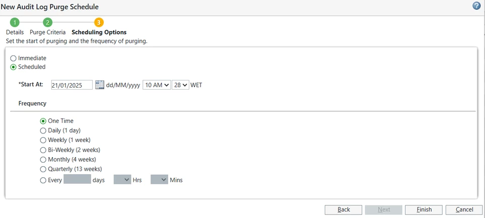

Jan 21, 2025 10:35 AM UTC
Hello all,
Thank you very much for your feedback. This confirm what we suspected!
Start and end date of purge criteria are static, this is the main problem. And if you try to select criteria by duration, it doesn't have the option of "keep last year" or something like this.
Of course, you could do it manually, but the end customer does not want to have to take care about that.
Let me share some screenshot to make it more clear to @avillanueva
Best regards,
Maite
18-Opal
Jan 21, 2025 11:22 AM UTC
@MaiteFarreny
Is this what you are looking for?
