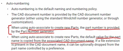

Keeping the same rules in place, File/New (in NX) creates the correct next in sequence number to replace the file name on save (from Help Center). On upload or check-in though, the auto-associate to create a new WTPart generates the new in sequence value for the Number. The name is fine (same as CAD).
This appears to be OOTB expected behavior (Help Center )

In Operation/Auto Associate there is a "Force Autonumbered Part Creation" preference that's set to no. As I read this, it ought to meant that the part would - on auto-associate through check-in - get created based on the CAD number. This seems to be in direct conflict with OIRs if you have autonumbering on WTParts.
Unfortunately, that's not my experience and the 2 softype method seems to be the correct solution. Just need to test this with the correct type to be auto-associated.
