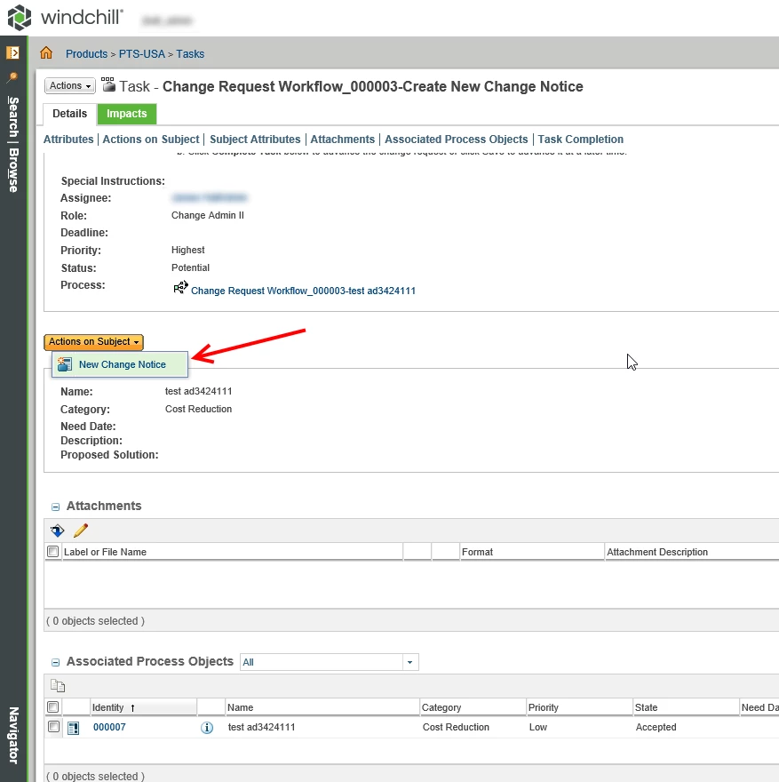

Feb 5, 2018 2:30 PM UTC
I would like to make this happen, but I'm having some trouble understanding the workflow here. This task seems hard to pin down even by PTC standards of foggy help files.
I'm using Windchill 11 M030 on IE 11 and Windows 10 and this is the closest thing I see to what the conversation here is discussing.  This "actions on subject" doesn't seem to provide an automatic creation of a Change Notice, just a chance to make one.  Is this what this thread is talking about, or am I off in lala land?
