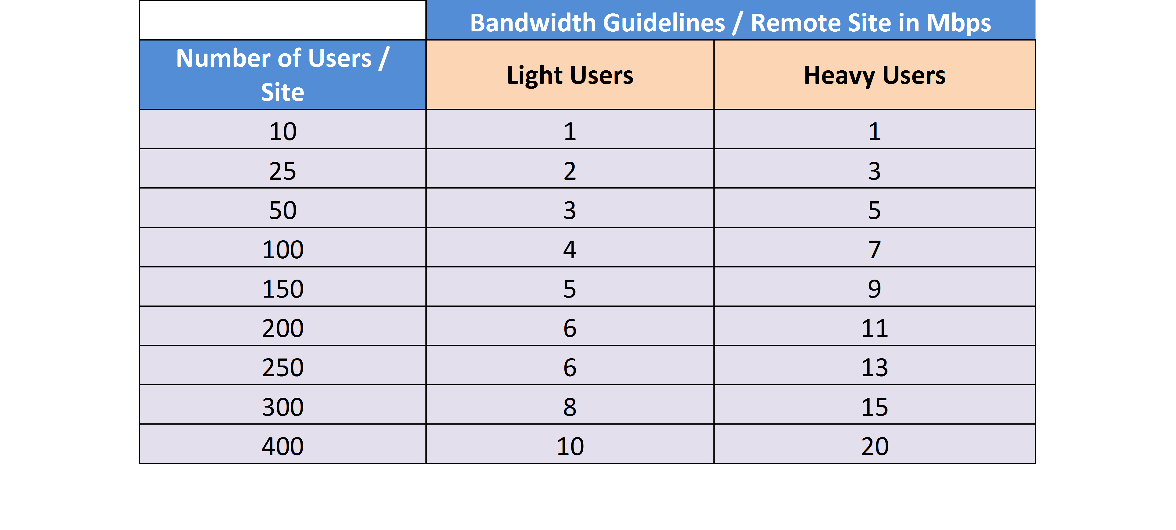

I would like to know the bandwith estimation per WEB browser client necessary  for server communication for MPMLINK . We suppose the following
-No use of CAD data

The below chart is what we use as a reference. However the bandwidth requirement is entirely dependent on pattern of usage among the users, other heavy applications which are sharing the same circuit, kind of data you are dealing with and so on.
You need to consider Network Latency, Congestion (% network utilization)  and Packet Loss. It is very hard to size the network without understanding environment and pattern.

Hi
I am sure you know that you can improve speed (from a user standpoint) with the use of replica servers. This allows minimal communication requirement between local sites and master site.
