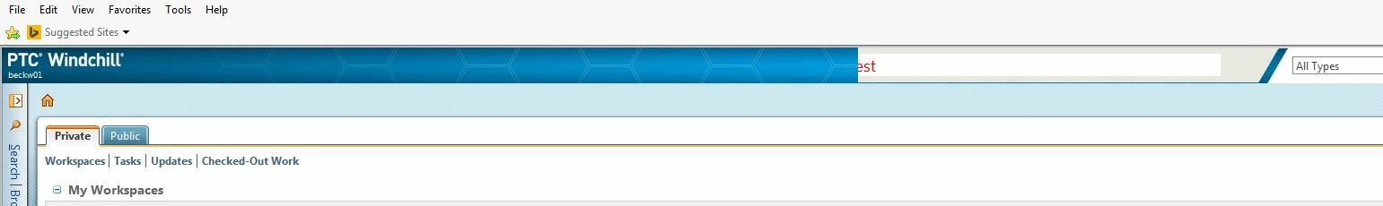

Banner being covered by image...
I have followed the directions in the Windchill Customization guide and even searched on the old exploder. I have not found a solution yet to this issue. I have tried changing the justification of the table and text and nothing seems to work. Any ideas?

Wayne,
Do you mind sharing the contents of your codebase/netmarkets/jsp/util/banner.txt file?
My contents are below. Some key characteristics of mine are float:left and margin:2px 170px and z-index:1000.

Feb 17, 2015 7:17 PM UTC
Sure...
<style type="text/css">
.bannertable {border: 2; background: #E7E8E0; text-align: center; width:
100%;}
.bannerfont {color: #BB0000; font-weight: bold; font-size: 1em;}
</style>
<TABLE class="bannertable" cellpadding=0 cellspacing=5>
<TR>
<TD>
<FONT class="bannerfont">
<center>
<table border=0>
<tr bgcolor=white>
<td width=800>
<font color=red size=+1>
<center>
</center>
</font>
</td>
</tr>
</table>
</center>
</FONT>
</TD>
</TR>
</TABLE>

Hi Wayne/Ben,
You can try below steps:
1. Update <Windchill_Home>\codebase\netmarkets\jsp\util\begin_custom.jspf to include following
<%@ include file="/netmarkets/jsp/util/banner_custom.jspf"%>
2. Add following (or whatever you want to display in banner) to <WT_HOME>\codebase\netmarkets\jsp\util\banner.txt
<div class="bannerdiv">
Alert: Windchill server will be shutdown soon for maintenance.<br>
Contact <a href="https://support.ptc.com/appserver/cs/portal" target="_blank">PTC Support</a> for your queries.
</div>
3. Add the following to the Windchill\codebase\netmarkets\themes\windchill\xtheme-windchill.css
.bannerdiv {
color: red; position: absolute; top: 2px; z-index: 1000; left: 200px; font-size: 14px ; font-weight:bold;
background: white;
width: 30%;
Note:
  • Please note that the Banner.txt file needs to be created for each Locale respectively.
  • That is, If your browser Language is set to say GERMAN (DE), then the system will look for <Windchill_Home>\codebase\netmarkets\jsp\util\banner_de.txt file
  • If the Locale specific file is not found, then an exception is thrown in the MS logs and Windchill header complains about the desired file not found.
  • If you wish to use the default Banner.txt file irrespective of what the browser language is set to, then add the following code to the <Windchill_Home>\codebase\netmarkets\jsp\util\banner_custom.jspf file :
Please have a backup of original banner_custom.jspf file before you modify it.
