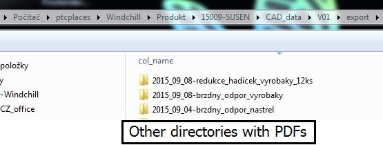

Hello all Windchill users.
Have a question about batch print PDF from PTC places.
Current state:
- PDF stored in PTC places (see folder structure below)
- in this state we can individualy open each PDF and print it
- together 250+ PDFs need to be printed
Idea 01:
- copy all PDF to local disk and print it with usualy way ---> too much work ---> time loosing way
Idea 02:
- print PDFs directly from PTCplaces ---> batch print isn´t allowed .
Professional way:
Could you give me some tip how to do it effectively? What is the professional way?
WCH/PTC Places config options:
- are there any options in conjunction to batch print, that l should know?
Note:
- PDFs are different sizes (A4, A3, A2 papers)
Thx for any tip or link
Best regards
Milan

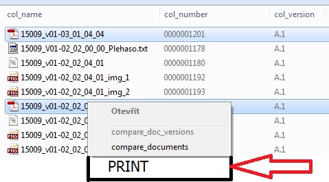

Randy thanks you for informations.
It looks, that my idea about direct printing from PTC places is bad? Please, see picture below.
Idea:
- select desired PDFs with CTRL or SHIFT button
- press right mouse button
- select PRINT
Have almost no expirieces with Windchill, so sorry about my primitive questions.
Have searched this forum and found no usefull topics...
Thx for help
Milan
Sep 12, 2015 9:13 AM UTC
Milan I don't think the feature you are asking for is "primitive". It's actually a nice simple feature request! Easy to understand and what you could expect and it would be user-friendly.
Unfortunately as far as I know printing -- or even better and more generic would be to have the ability to add something like "Send To" which is then configurable and extendable like it is in normal Windows Explorer -- is currently not part of the "Windchill Desktop Integration" feature (which is the usual Windchill name for what you call "PTC places").
So that means you need to create an enhancement request in the Idea area here on this website. Then others can vote for it and PTC might implement it.
Until the feature you are asking for gets available you might look at batch printing from the full "Normal" web-browser based user interface. I have not explored it in detail but know there is something available via searching and collection into the "windchill clipboard". Try searching the windchill online help for "batch printing".
Alternatively some setup as Randy suggests might be needed.
