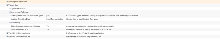

I'm trying to get batch printing set up.  My preference screen looks like below

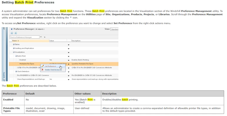

What the help window shows is the added batch print option.

Windchill Print Services is a separately purchasable Windchill option - is it possible that you don't have this, or aren't licensed for it?  Because then the preference would not be there.
Online help topic for Windchill Print Services:
https://support.ptc.com/help/wnc/r12.0.1.0/en/#page/Windchill_Help_Center%2FWVSPrintMgmtIntro.html
Knowledge article on same topic:
https://www.ptc.com/en/support/article/CS39963
I'd suggest opening a Support case for this, as we do have a Support team, that specializes in the Visualization/Windchill Print side of things (I'm not part of that team), which should be able to answer this for you.
