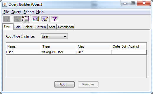

In that case then I'd recommend using Query Builder. Pretty straight forward.
Site --> Utilities --> Report Management. From the top right, pick "New".
On the From tab choose "Add", then select "User"

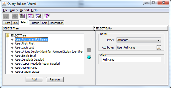

On the Select tab use "Add", then use the selection box next to the attribute to choose the information you want to view.
Chosse "save", then "choose" generate.
Select all of your chosen criteria, then click "Generate".
