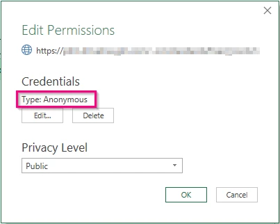

Anonymous.pngLooks like you need to switch credentials to Anonymous

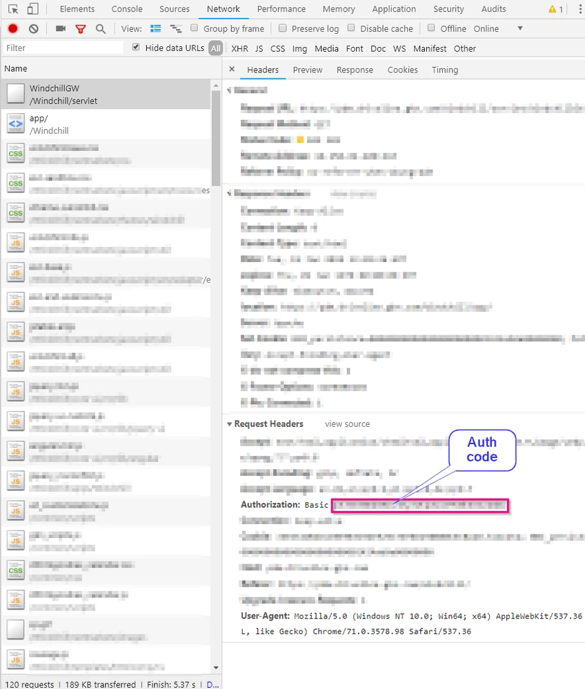

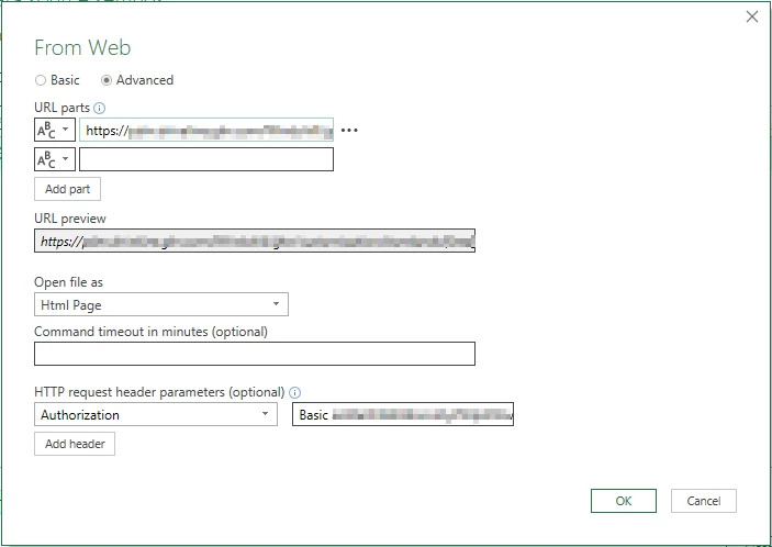

Then authenticate with a special header parameter:
Authorization: Basic user_password_code
Make sure code is preceded by “Basic”+”blank space”
Screens below where to set that, how I get the code, it is my Windchill and Chrome Dev tools (F12).
Now your Power BI authorize successfully.

Datasets on powerbi service cannot be configured with HTTP request header parameters (Authorization “Basic”+”blank space”) so I have to use one of the three  authentication methods.
