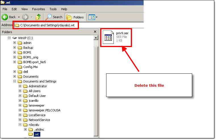

January 20, 2010
Mike,
Try this. We do this all the time.
Delete priv9.ser for the user (please see below)
Have the user Accept (Grant all permissions) it prompts next time.
Rekha
From: Lockwood,Mike,IRVINE,R&D [
22-Sapphire I
January 20, 2010
Great thought - Just tried it - no effect.
