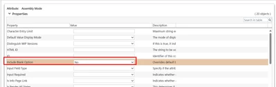

can you set this on the create layout  :
Buiꓘa
Sep 12, 2025 2:03 PM UTC
Hello @Fadel. I am able to do that. However, as mentioned in my original post, this will not work for me since I do want the value of attribute 2 to be set to blank when attribute 1 is set to blank. Therefore, I believe I would need to include blanks in my dropdown lists.
