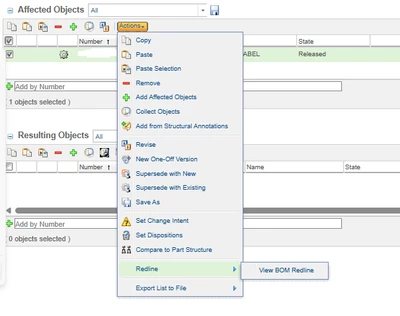

BOM Redline
Version: Windchill 13.0
Use Case: BOm Redline is not visible on the affected objects table when the object is in released state.
Description:
creation of BOm Redline action is not visible on the affected objects table when the object is in released state.
Jul 2, 2025 8:09 AM UTC
The issue is fixed after setting the preference under Site Utilities Preference Management BOM Redlining

When you say "the object", do you mean the objects in the affected objects table? Screen shots and examples help also.
Jul 1, 2025 12:05 PM UTC
I have added a released version of a WTPART in affected objects and trying to create a Redline on this. There i dont see the action to create one.

Can you verify that the other conditions are met? Preference and xconf settings are enabled. You have proper license (likely Advanced Windchill license I think). if custom workflow, that variable is enabled? If you want to see what is blocking the action, try adding &jcaDebug=true to URL.
