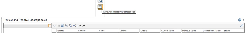

I have studied review and resolve discrepancies function.
Currently I'm not satisfied how it is recognizing changes and maybe we need to discuss also about it.
Is this how it should work or can I achieve better end results with example some preference changes?

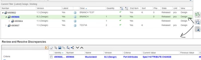

Assembly 9000 (design) is reused and is not marked with the "equivalent parts exist but does not point..."
But... inside the part is part 5000 what has been revised and is now B.1. Our manufacturing view of that specific part still points to the A.1.
Inside the assembly 9000 at the part 5000 is the equivalent part exist but does not..." but we can't see it at the assembly level, also based on my tests we also can't see that through review and resolve function without somehow knowing that in that specific assembly is a design part that have been changed.
(If it is example attribute change)
So... is the review and detect function also working as the filter. It does not have ability to go inside the structures?
In pictures:
When I select the highest assembly, it doesn't detect that there is changes done to its child parts. (And this is just few level structure)
I have to go to the specific structure that have faced changes or open all sub-assemblies and paint all --> then select & click detect to find that there is something changed.
That is why I want to filter/see the assemblies and parts to see is there "equivalent part exist...." parts"
Also when operating with big structures, sometimes if I select too much parts the detect will just fail.

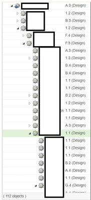

Filtered picture to get a point that structures go in many levels in my situation and I can't be sure if there is something changed even before I'm starting creating manufacturing view.
It is possible to import the whole BOM to excel and look from the equivalent out of date. But in my opinion these kind of steps in BOM-transformation should not be necessary, the wanted result should be achieved without excel filtering.

Hi @VVII
Try to select all levels and use the function.
It should go throw all selected subassemblies but only if they are selected.
