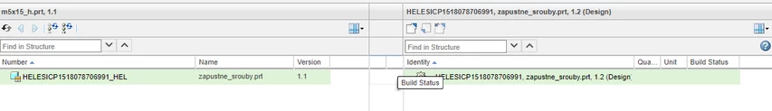

HelesicPetr
Nov 21, 2023 1:42 PM UTC
Hi @handers-2
In the system there is definitely that API because it is used in the compare functionHelesicPetr_0-1700573917015.png
but it has not to be just one function it can be a several functions together that compares build status and others information.
You just need to find that API.
PetrH
handers-28-GravelAuthor
8-Gravel
Nov 21, 2023 2:04 PM UTC
Hi  HelesicPetr,
I know this compare, I decompiled already a lot OOTB files. I dont find a way.
com.ptc.windchill.enterprise.dsb.client.controller    DSBController.java -> the result is stored in compareSummaries
I thought this could be an option: BuildHelper.isMarkedAsBuilt((BuildableLink) link))
But the buildable link looks like it has to be a WTPartDescribeLink which for me does not make sense.
EPMDocs are not linked with it. And BuildRule or BinaryLink is not castable to "BuildableLink"
