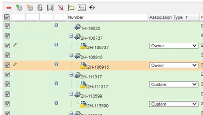

Hi Guys,
Can we change the association type bulk in Windchill?

Via API I am sure but how many do you have to change?
Apr 2, 2025 4:16 AM UTC
@avillanuevaThanks for the reply. I have more than 15K data, but I can work with 1000 or 500 as well. Please guide me on how to use the API for this.

Looking again at your screen shot. The association type shows "custom". What is that type is that? I am linking to some Knowledge Hubs to get you started.
[Knowledge Hub] Windchill PDMLink - Association Types of CAD Document/WTPart
[Knowledge Hub] Windchill PLM - WTPart/CAD Document Association Customization
If this is an initial load that you now want to change, it might be easier to delete the data, change your preferences to default to the right association type, then reload the data.
