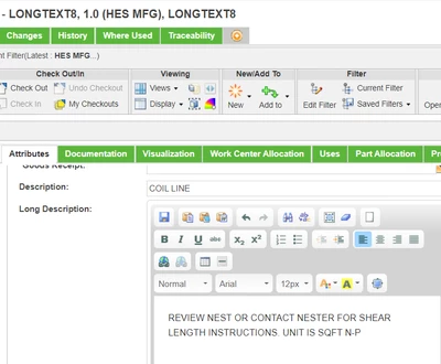

I am trying to bulk load Operations by using the LoadFromFile. The field LongDescription in most of the cases consists of multiline text. Below is the way the xml is currently being generated:
<csvBeginOperation handler="com.ptc.windchill.mpml.processplan.operation.LoadOperation.beginOperation">
<csvuser></csvuser>
<csvname>OP000001</csvname>
<csvnumber>OP000001</csvnumber>
<csvcategory>production</csvcategory>
<csvdescription>COIL LINE</csvdescription>
<csvlongDescription>REVIEW NEST OR CONTACT
NESTER FOR SHEAR LENGTH
INSTRUCTIONS.
UNIT IS SQFT
N-P</csvlongDescription>
<csvdefaultUnit>ea</csvdefaultUnit>
<csvfolder>/Default/Operations</csvfolder>
Unfortunately, the line break seems not to be recognized/detected.
I tried to replace the carriage return with "&#10;" (after reading a PTC document) but I had no luck
<csvlongDescription>REVIEW NEST OR CONTACT&#10;NESTER FOR SHEAR LENGTH&#10;INSTRUCTIONS.&#10;UNIT IS SQFT&#10;N-P</csvlongDescription>
I have tried also with "&#xA0;" and "&#160;" but they require to be declared in the xml and I am not sure this is the right way.
What am I missing?

November 26, 2022
The Character Data tag can be used for this …
<![CDATA[some stuff]]>
add it inside the description, then new lines can be written in the normal ways.
11-Garnet
November 28, 2022
@rhart , thank you for your hint. Unfortunately this does not seem to resolve. Following is what I put in the xml:
<?xml version="1.0" encoding="UTF-8"?><!DOCTYPE NmLoader SYSTEM "standard12_1.dtd">
<NmLoader>
<csvuser></csvuser>
<csvname>LONGTEXT7</csvname>
<csvnumber>LONGTEXT7</csvnumber>
<csvlongDescription><![CDATA[REVIEW NEST OR CONTACT
INSTRUCTIONS.
UNIT IS SQFT
N-P]]></csvlongDescription>
and this what was created
