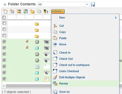

Hi guys,
Can we do bulk revision in Windchill?
Aj
HelesicPetr
Dec 17, 2024 1:00 PM UTC
Hi @Amirtharaj_K
What do you mean bulk?
From a file?
You can use restAPI to revise WTDocument, but for a CAD rest API does not exist
or
user can do a revision from a workspace on all objects in the workspace
also it can be done from the Folder

Jan 6, 2025 8:26 AM UTC
It's restricted in Policy Administration. After giving access, I can make bulk revisions. Thanks @HelesicPetr
