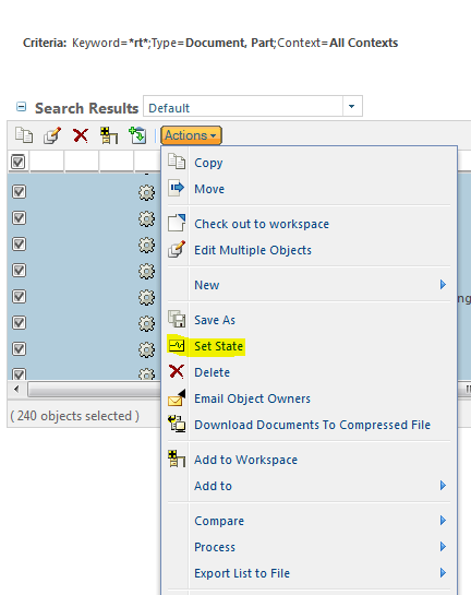

Jul 14, 2014 6:58 PM UTC
Just so you know, the ability to use the multi-select Set State action from the Search Results table will be available starting in 10.2 M030. This is in response to feedback in the Product Ideas forum: http://communities.ptc.com/ideas/1597#comment-13382
From an M030 test server:
