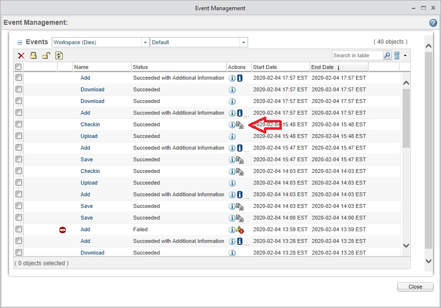

Frames are like snapshots of how the workspace looked at a certain point in time.  You can roll back to them to undo recent changes or recover something that was deleted.  You can see these, and delete them if so desired, from the 'Event Management' page.
There are multiple ways to access the event management page.  From Creo Parametric it would be File --> Manage Session --> Event Management --> Server Name.  You should see a window like the one below.  The rows with the paper icons are the frames.
