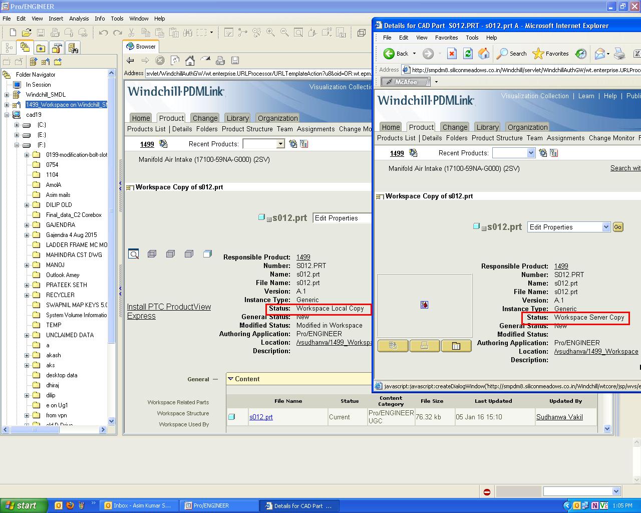

In Wildfire have connected to the Windchill server and opened an assembly from hard disk and performed save. I have not performed upload or checkin but this saved data is visible in IE/Mozilla.
On accessing the information page for these parts it shows "Status:Workspace Server Copy"I am aware of the client side and server side workspace in Wildfire-Windchill. This data should not be visible in IE unless it is uploaded or checked in that is when it moves to server side workspace or commonpsace. Please let me know how this data is visible in IE when it is just saved in connected session. Am I missing something

There is a difference in the "status" value for a particular part in Wildfire embedded  browser and IE.  Is this is expected?  (image attached)Status_Diff.JPG
Thanks - Amol

This is working to spec, newly created data will be a local copy and will be visible as Workspace copy only. In your case your IE browser is also showing workspace copy.
I think you just copied the URL from WGM to IE, is it so?

Not using WGM. I am using Wildfire with its embedded browser and IE.
Accessing the same CAD part from workspace in both the embedded browser and IE hence the information displayed should be the same!

Tom is right, unless you upload the files you will not be able to see on any standalone browser.
