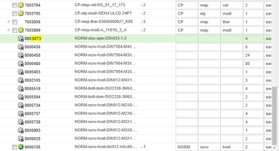

I am unable to get the Part BOM to populate correctly, I have associated the parts in the single level but in the multi-level, the part is not recognizing it. i am not sure how to fix this or what the root cause it. anyone else ever had this issue or have i misunderstood how to associate the part
Creo 6 + Windchill 11

the set up was not done correctly from our system and was fixed by the admin from the provider. thanks everyone for contributing.

There could be a number of reasons why it did not built. If the association to the CAD model and its part is not OWNER, Image or Contributing Image, it would not appear on the WTPart structure. If the WTPart was deleted at some point in the past, it could not build. You are in the right UI since I believe there is a way to have that correct the deletion and build it. I just forget off the top of my head where that was.
AnthonyC12-AmethystAuthor
Nov 14, 2023 8:06 AM UTC
my CAD model and the part are linked as owner/child.
i looked a bit deeper, and looking into the WTpart BOM shows that only the item master is loading in for some reason. is there an easy way to switch from item master to child?

Hi @AnthonyC
Usually it means that you do not have access to the specific versions.
Or the filter definition does not find the specific iteration based on your criteria in the filter.
You need to contact windchill admin to add you correct roles or set correct acl definition to grant you the rights to see the wtpart.
or change filter criteria.
