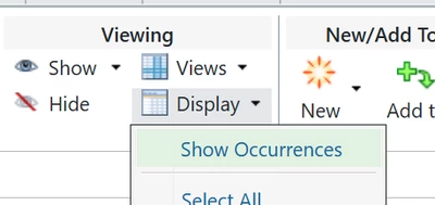

Is there a method to configure a CAD driven BOM structure so a component (Qty 3 in CAD assembly) is listed three times as qty 1 for each occurrence so a COLOR usage attribute can be assigned to each?

11-Garnet
Aug 13, 2025 5:09 PM UTC
Thanks for reply, Ben; but my question applies to the structure in PSB, not a repeat region in a drawing.
joe_morton
Aug 13, 2025 7:34 PM UTC
In the Display dropdown, click Show Occurrences:
