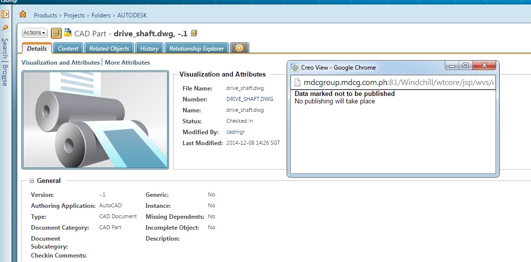

I Installed and registered the cad software (Autodesk2014) in workgroup manager. I upload a file but I have some problem publishing it.
This is when I click on the visualization.

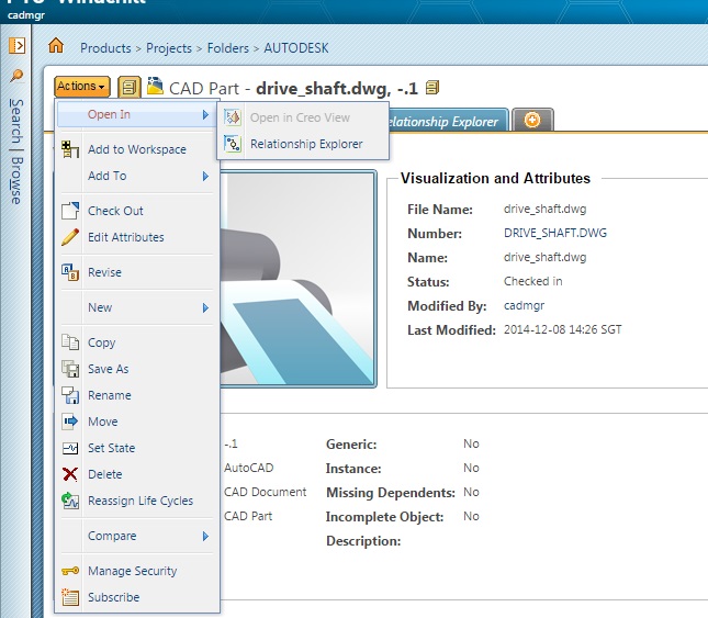

Why my creo view is disabled?
Thanks!

Luar1-VisitorAuthor
Dec 9, 2014 8:44 AM UTC
Hi Vitaliy,
Yes, But thats my problem now, Publish is not working after I checked in using WGM. As u can see on my screen shot. I dont know what is wrong.
