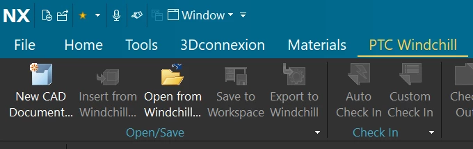

We’re mostly NX and SW with WGM and I do notice this yes. I ask that the users use the “Open from Windchill” PTC Toolbar menu to open from Workspace. Our office setup is 2 monitors as well, so WGM is on one screen and CAD on the other so this ends up being a non-issue.
